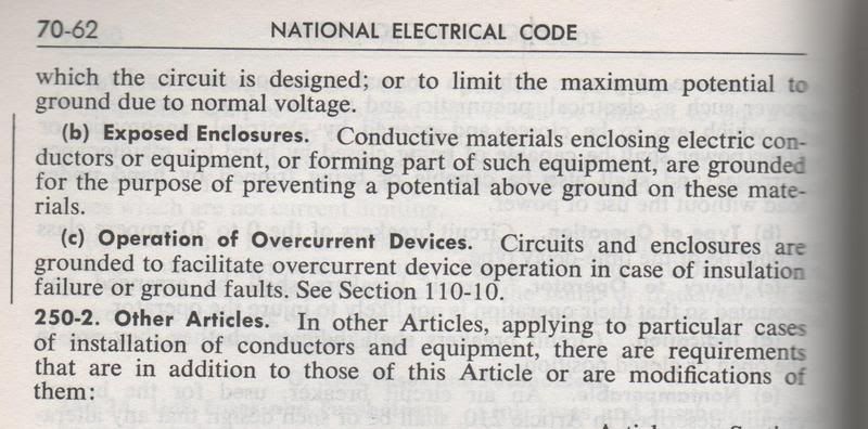

250.4(A) (2) Grounding of Electrical Equipment. Non?current-carrying conductive materials enclosing electrical conductors or equipment, or forming part of such equipment, shall be connected to earth so as to limit the voltage to ground on these materials.
As long as this section remains then the only thing that the green conductor can be called is equipment grounding (earthing) conductor.

I agree that Article 250 has a lot that needs addressing. I agree that the only conductor that needs the label ?grounding? attached to it should be the one that directly connects to earth
But
This is not what the requirements of 250 states.
I believe that the requirements of 250 need addressing instead of the way grounding and bonding is taught.
A lot of what is being said and done with grounding and bonding has a lot to do with some of the old requirements of the NEC.
If I may be allowed to touch on a couple that we all can relate to I can show these misconceptions.
One is that metal water pipes in a house are to be continuous through out including jumpers across the water heater although no rule can be found to substantiate this.
I have see those that use the requirement that the connection from an electrode to the pipe be continuous and those who say that the hot and cold pipes make two different systems to try and justify a rule that doesn?t exist.
Another misconception that is sometimes seen is the installation of a rod at a pool or outside tub. Then let?s not forget the bonding of the mixing valve for the hot tub. None of these can be substantiated although a lot of inspectors will try to enforce or some electrician will call anyone that don?t do these things plumb crazy.
The rule found in 250.4(A)(2) is very clear that all metal pertaining to an electrical system SHALL BE CONNECTED TO EARTH.
This is where that we need to start addressing the equipment grounding conductor and changing the name to equipment bonding conductor.
We can keep addressing your star connection as the point of bonding and keep teaching that the equipment grounding conductor is to ground metal to earth or we can address the rule to connect everything to earth.

I am saying that 250.4(A)(2) and (B)(1) ?requires? that anything that the Equipment Grounding Conductor is terminated on be connected to earth to stabilize the voltage to earth.
250.130 clearly states how I am to connect the items mentioned in 250.4 (A)&(B) to earth.
(A) For Grounded Systems. The connection shall be made by bonding the equipment grounding conductor to the grounded service conductor and the grounding electrode conductor.
In my honest opinion if the requirement in 250.4(A)(2) and (B)(1) were removed 250.110 could be left as it is and the word ?grounded? could be changed to ?bonded? throughout article 250 without any problem.
