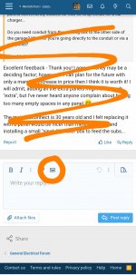

I drew a picture first, but sadly couldn't figure out how to post :-( I will work on it...
Take a picture of your drawing with your phone. Then when you Scroll down to make a new post, you'll see an icon that you tap, and it will allow you to go into your gallery. Then you can insert your picture.Screenshot_20230628_120248_Chrome.jpg
THANKS! For some reason I thought it required third party hosting.
