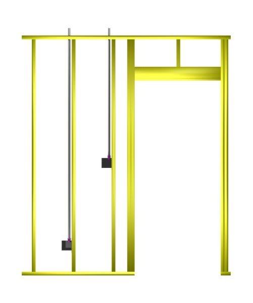

It should be parked back by there again in a couple of weeks. Assuming they ever answer my e-mail (grrr). I have 13 pages of "how to play with PVC" written thus far, complete with pictures I whipped up in CAD.
Here's one of them --

The drawing looks good, but if you are dealing with people who have no experience, I think that you will need to show the required condcuit supports.

don_resqcapt19 said:
tallgirl,
Don
She did, Don. Arn't the boxes supporting the conduit? :D :D :D
BTW: I can't believe the big residenial EC's havn't jumped on the work. Makes me think theres something somebody isn't telling about. I smell a rat, or in this case a fish out of water!
tallgirl,
Don
I will in other pictures. The CAD program I have can't "bend" an extruded solid, so doing that would require that I construct a small offset by hand, then insert that between a piece of straight conduit, in order to show the conduit clamped against the stud. That picture is where I illustrate height differences between boxes for switches and receptacle outlets, so I didn't want to complicate it with clamps.

Nice CAD work.... Back on topic, I'll repeat the advice of "Smurf tube" for your specific purpose if allowed by code there. (I would check, but thier site seems to be down? IBC with ammendments?) If so would also suggest plastic boxes, and plastic rings. Just for cost and ease of use to the totally unskilled. Also cheap, and could be re-claimed in future flooding... Simple rules of "Less than 360 degrees of bend - point to point" - "Less bends the better" are pretty easy to follow. From what I understand, you are trying to just get some sheet-rock progress work done, and pull later? That might be your ticket...
As for operationally, I would suggest having an Electrician lay-out the work for others. (If allowed to do so) You can use a method like this, and feel free to use this document if you like.
