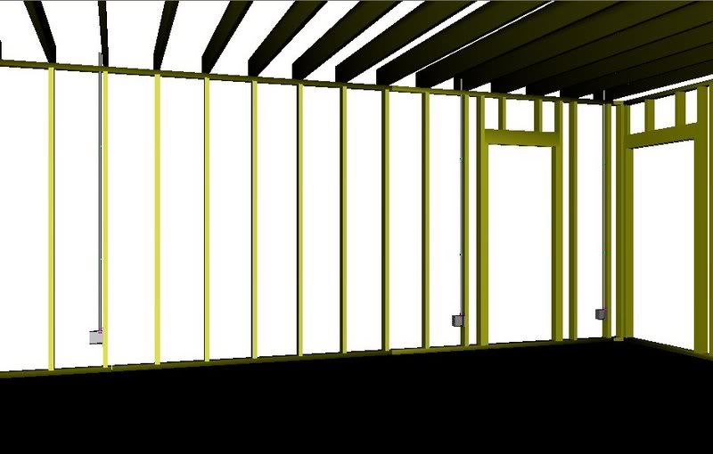

More CAD :)
More CAD :)
This is mostly about 210.52 (A) (2) (1), it also illustrates the 12' spacing between outlets, though the distance is actually less.
