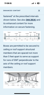

While I will say the language used in the exception may not be completely clear as to intent, but the explanatory material from the nfpa link enhanced content speaks to intent , and I’ve always read it the same way
If you’re running parallel with framing like you were, how does the framing prevent you from securing the conduit where required?? You are running along the framing even if you’re in the middle of the bay you have access to framing members to use a TSGB-16 or offset over to the actual stud and strap the conduit to the stud
Exception 1 may not specifically say when running perpendicular to structural framing members , but what it does say is you can increase the distance to 5’ when structural members don’t readily permit fastening within 3’ .
you have a short raceway between 2 boxes that runs parallel to the studs in the bay and both boxes are secured to the framing parallel to the raceway . How can you say the framing doesn’t readily permit fastening within 3’ when you’re running with the framing , and the boxes where you terminate the conduit are both secured to that parallel framing ? The framing definitely allows you to securely fasten the conduit anywhere between the boxes
So exception 1 is not applicable, but that doesn’t mean you were required to add a means of securement , I feel it’s securely fastened in place with fittings on each end that secure the conduit to each box that is rigidly secured to the surface , the rule doesn’t say it must be a strap , just says securely fastened within 3’ of box/enclosure/conduit body
