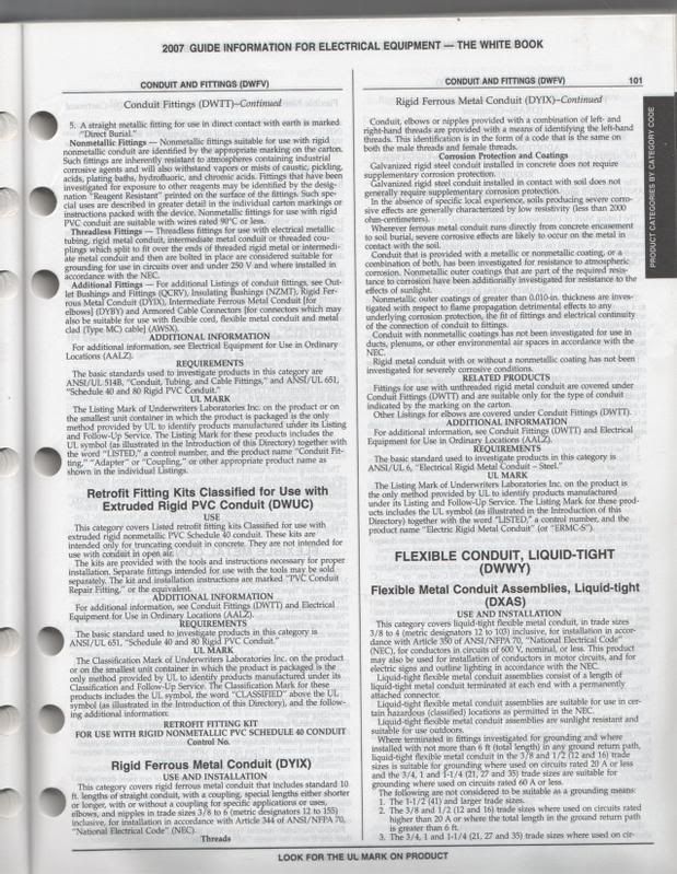

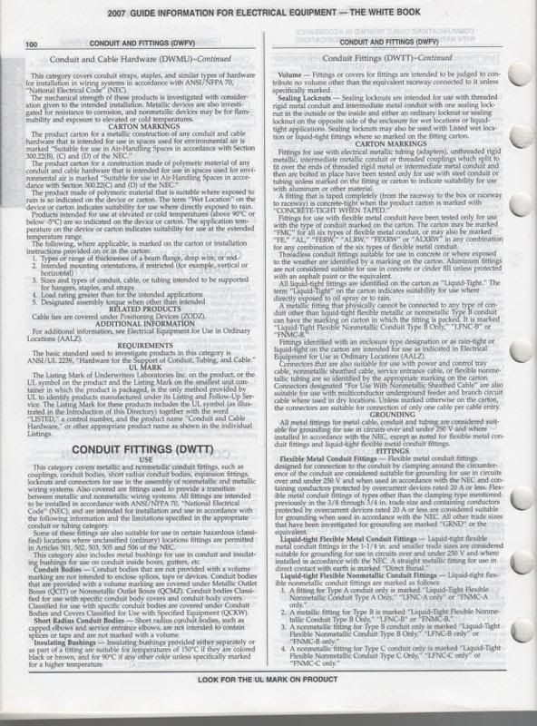

LJSMITH1 said:
I don't have a copy of the white book in front of me, but are there any limitations of other types of fittings outlined in the book?
Well here is page100
And here is page 101
