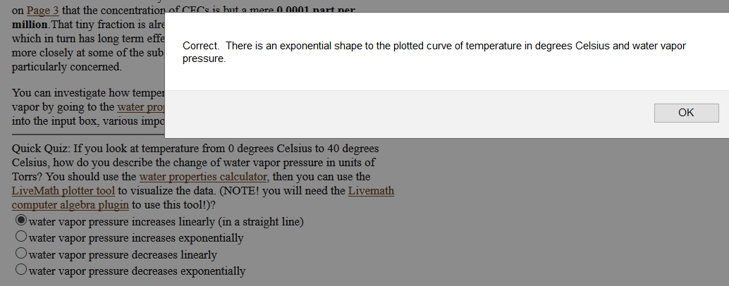

Well, not sure i trust any of these links.
I select "increase linear" but the answer says "correct, exponential" ???
