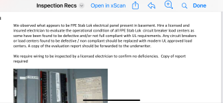

this is what they wrote. All I see is replacing the panel or since it doesn’t show any signs of danger at this time all you can do is thermo image it to make sure no hot spots are available, proper torquingof all connections and check for loose connections or oxidation. Any thoughts??????
Looks like a inspection report, pretty common 3 phase panel, I would IR image the panel and look for any 'wiring deficiencies', like oversize breakers, missing k/o's, Then wait for what their insurance carrier asks for.
I love how the inspectors wrote "We observed what appears to be..." Almost as useful as our sales reps going "These guys showed up on the over-consumption report with a value of x. Could you give me another reading, using the historical database written by that exact same tool over the same time frame, to verify?"
