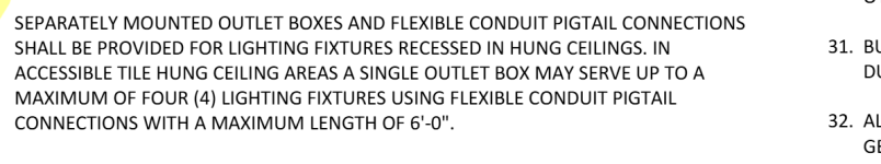

Not an access door Rob. It's a flange kit for troffers. You either frame it or give the framers dimensions at rough-in and they cut out the hard lid at finish. You install the trim kit (flange kit). If your j box is directly over or close to the 2' x 4' hole, you can always get a ladder in there to access it.
We did this for decades but this is no longer permitted per 410.118.
Well damn! I just got educated today! :) I did not know that they made addition to the Code. Thanks.
I'm not a fan of this code change. If it's broken why fix it? With Sheetrock or plaster ceilings a box above the fixture was the way it was done for 100 years. Not sure what the logic is for this code change.
If by hung ceiling they also mean sheetrock ceilings then yes if would not be permitted if the only acces is removing the fixture. This is a newer code requirement maybe they're not aware of it.
That's one way of doing it but with a sheetrock ceiling it's no longer code compliant to have to remove the fixture to access the box. Needless to say that the way it was done for 120 years.

It was mentioned earlier in this thread. 410.118. Boxes are permitted above sheetrock ceilings they would require access without removing a fixture like through an access door.
Sorry, know I'm repeating. What code cycle did that change? What code section? So essentially a sheetrock ceiling will not contain any boxes above the ceiling and you would have to wire directly into each fixture? A box not being allowed above sheetrock ceiling with no access door would go for a fixture box, homerun box, pull box et.?
The change was made in the 2020 NEC
