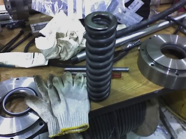

Here's a nice little spring for you.:D Part of a draw collet mechanism. The spring holds the part during a lapping operation. It's uses a 6" diameter dual-piston air cylinder to unclamp the part. It takes a special tool to compress and decompress that dude! How have no idea what the rate of that spring is but I've worked with bigger ones.:rolleyes:
