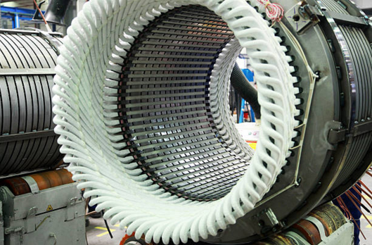

If you can peek into the housing and see the coils, Form Wound would have square or rectangular conductors pressed into precise neat shapes and often vacuum impregnated insulation around them. If you see small round wires wrapped in what looks like sting or tape it's random wound.
Form wound:
Random wound (with some damage):
200HP would be a generous lower limit of size to find form wound. It's usually motors that are "above NEMA frame", generally equating to over 250HP at 460V, and even then it's not common until you hit maybe 500HP and up.

That's am image from EASA (Electrical Apparatus Service Assoc) from a website on leading indicators of different types of motor winding damage. I believe that image was for first-turn insulation breakdown, likely due to being operated on a VFD, and likely 460V. I was just using it as an example of random wound motors.
Here is the updated website for that if you are interested. The image I used I think is from an older iteration.

More helpful to actually see a form wound and random wound coil out of the motor. Or the diagrams showing a cross section. But the best way is to see them up close and see them installed in a winding shop. Oh there I go again. Books are superior! I must not condemn the engineering profession. Only calculus is truth. All others are inferior. Fifty lashes for my blasphemy. I am not worthy, not worthy,
Seriously it never truly made sense to me until I actually saw it in person.
