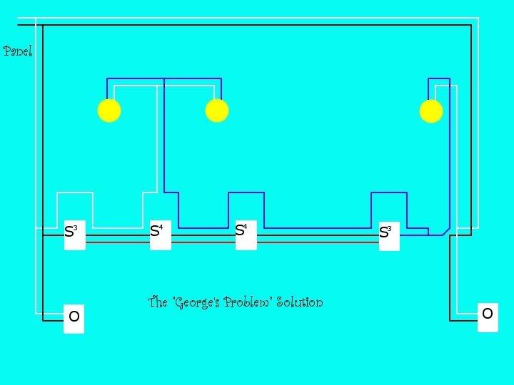

I came in very late on this one hope I do not look like a fool. 3 way switch has three poles and a 4 way switch has 4 poles.....that is the theory that I know.
I disagree with that.
IMO a 3 way is a one pole double throw.
A 4 way is an odd type of two pole switch
Yep. It's a DPDT switch that's been wired internally so the 5th and 6th terminals aren't needed and hence aren't visible.
You could easily make a 4 way switch with a DPDT switch by using 4 of the terminals (one for each conductor) and installing two jumpers on the unused terminals and the two used throw terminals. If I could draw it on this thing I would.
Inputs are 1 and 2, outputs are 3 and 4 (or vice versa -- doesn't much matter to me ...)
1 2
3 4
5 6
Jump 5 to 2 and 6 to 1.
I'll draw a picture if anyone still doesn't get it.

Here's the wiring diagram for anyone still following along at home --
georgestolz said:
Your picture looks purdier than mine. :)
That was done with something called "The GIMP", a free graphics program that's available for Windows, Linux and just about everything else. Plus, I've been drawing wiring diagrams since before you wuz borned, as I recall.
And you could have avoided that "California Hootenanny" with two lengths of 14/4.
