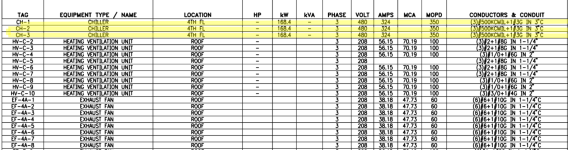

Sorry for all the questions. So the 6P disconnect switch I asked about earlier makes sense as you can see the (6) #6's.
1. If I have to replace fuses in this MCC there would be SIX fuses?
2. How would I determine the size of the fuse? The disconnect switches at the units are 60A but I also see the Amps and MCA below for those same units. Assuming fuse ion MCC needs to be at least 60A?
