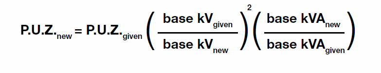

I have a 208V 3P 250KVA generator , and alternator data is in the picture below.
Since my generator is 208V, so I need to convert my alternator reactance from 480v to 208v.
Base on the formula:
X0=0.08*((480/208)^2)*(250/250)=0.426
x'd=0.19*((480/208)^2)*(250/250)=1.0118
x"d=0.17*((480/208)^2)*(250/250)=0.9053
x'd is large than 1, it does not make sense. I try to do the research. The formula is right.
But according to number i get, I can tell something is wrong. But I don't know how to make it right.
Anyone know the reason? and provide any article for me to read?

I see. Well, you'll be glad to know your conversion is actually correct. The Z base for 480-V (0.927-Ω) is higher than the Z base for 208-V (0.173-Ω), so if you multiply the p.u. for each case into the respective Z base, you get the same value of actual ohms in both cases. Note: There is nothing abnormal about a X'd p.u. larger than 1. You are converting to a lower V base, so larger p.u. is expected.

Just punch in the figure you find from the datasheet. Understand that the value of X" (subtransient reactance) is in the range of 12% -20%. Then, the transient reactance X' will be a bit larger (19% in your data) and the steady state reactance X even greater than the previous figures! There's no need for you to calculate as the software does those if you punch in the correct base values (kV and MVA bases)

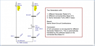

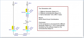

Interesting... I just modeled this in EasyPower. It appears the software automatically handles the conversion based on the Generator Rated kV and the connected bus Base kV.
You can model your system as per below. You can see equivalent short-circuit contributions are produced for GEN-1 (480-V) and GEN-2 (208-V) with using the same generator %Z values as given in the datasheet. You can ignore the transformer in this example, as this is only needed to interconnect 480-V and 208-V buses (I set the transformer impedance as low as the software would allow, so its as if its not even there). Hopefully this resolves the confusion...

Your Gen-2 gives the exact same result as in my example. Not sure what you are doing for Gen-1. What Generator Rated kV are you using for Gen-1?
sorry for that, i found out that Gen-1, I did not change the Voltage in the gen-1, so I delete the post. the result is same as yours, after i correct it.
