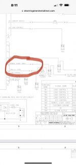

Generator Controller
You will probably have to go with a commercial version of Kohler, or Cummins/Onan. Any brand that has a two wire start capability. I don’t think Generac has any until you get to the bigger sizes. RV generators are mostly two wire start, but most are only 120 volt output, until you get the bigger generators. You will also need a two wire start compatible transferswitch, where Generac’s is not without a lot of modifications. I have a 20KW Cummins/Onan, and it appears to have remote start capability. It’s not much more in price than the Generac.

Most standard well pump pressure switches are double pole, are both poles being used? The float switch should be common to all of the booster pump contactors, so that should free up one of the pressure switch contacts. That contact can be used in series with a 12vdc on delay relay that is in series with the start contact from the transferswitch. The generator will only start if power is lost, and any pressure switch is closed. Use a 20 KW generator so all pumps can run if needed, so additional load shedding would not be necessary. If you use a time clock, it will need a separate power source to keep time if mechanical, or power to transfer the contacts when utility and generator is off. Took about 15 minutes to design that. Can draw it out when I have more time.

Finally got a chance to draw it out, the pressure switch contacts need to be parallel instead of series, and with an off delay instead of on delay relay. If the off delay relay fails, generator will run as normal, it just will not shut down once the load is satisfied.

Yes, once all loads are satisfied, the timer starts, but resets if any of the pressure switches close again, and yes, use power from the generator battery.
The Cummins/Onan has programmable load shed relays that can be used to lockout however many pumps you want when the generator is running, and one output could be used to drive a time delay relay to delay the loads when the generator first starts.
