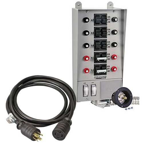

I think JWElectric has made a a lot of good points here. However, companies like Reliance, CH and others are still producing panels like this one :
http://www.electricgeneratorsdirect.com/product-images/30310AK_New_500.jpg
So, irrespective of whether anyone thinks JWElectric is correct or not (and I happen to think he is), as long as these xfer panels are being produced they will be installed, perhaps not by those who are getting an education here in the Forum but by many across the country. I think the education process has to start with the manufacturer and not with the installer. Just my opinion.

People are going to do what people are going to do and no matter what kind of switch is available won?t change this.
I heard someone compare this argument to the game people with a wheel gun, putting only one shell in is far safer than putting in three, four, or five would be. It won?t much matter how many are loaded when the hammer falls on just one shell.
Yes people will do whatever it takes when faced with extreme conditions but compliant is compliant and as an electrical contractor what I install must the safe and compliant.
I cannot justify doing something that is non-compliant and making the remark that it is far safer than what I saw someone do last week.
The trip hazard of a cord is far less a safety hazard than electrocution or fire due to a non-compliant installation. During power outages at my home we have a couple of cords to supply temp power to lights and sometimes to the frig and freezer. These cords don?t lie around all day long.

Seems to me this thread has gotten way off the mark or something. All I wanted to know was when you have to wire between a subpanel used as a manual gen transfer panel or any other panel like Reliance,Genrac,that is used as a subpanel/manual transfer device when you bring the circuit conductors over from the exisiting main panel to the sub do you have to run separate neutrals for each circuit conductor or could you just pull a large neutral in the pipe or raceway. Separate egcs are not required so long as you pull one in each raceway equivalent to the largest load in that raceway if using flex or nmflex. Code tells us that we need to run a neutral with the circuit conductors but my question was is a separate neutral needed for each circuit conductor or one large neutral in each raceway? Just had an install where I had to run up over a doorway to an adjacent wall to mount the sub. Little trickey getting all the wire over with derating and such. had 7 15 amp circuits,5 20 amp circuits,one 30 amp circuit, the main power to the sub,and the 30 amp circuit from the outdoor outlet back over to the subpanel gen breaker to contend with.
The thread seemed to have diverged from the original question or did I miss something.
If you're using this type automatic transfer switch/sub-panel : http://www.electricgeneratorsdirect.com/Images/Generac-Guardian-RTS16EZA1/i4828.html with a UL listed generator that it's paired with, the neurtals have to originate in the panel the branch circuits are fed from.
If you're using this type manual transfer panel : http://www.electricgeneratorsdirect.com/Images/Reliance-Controls-51410C/i1127.html with a portable generator the design is such that, while on utility power, the branch circuits are still being fed from the panel they originate in. The individual switches serve to switch each ungrounded branch circuit conductor from the breaker panel onto the generator. The neurtal is back-fed from the generator to the neutral bar of the breaker panel.
Now, as JWElectric pointed out this is not considered a Code compliant installation.
