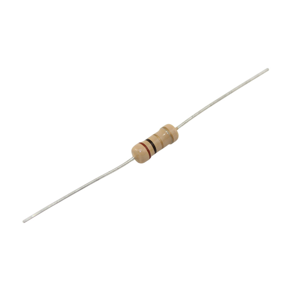

If I bond one end of this to the equipment grounding bar and apply a voltage to the other end will the both ends be at the same potential?
That is what you are asking of water and in this thread we have learned water is a poor conductor. I am willing to bet the minerals that it would take to make it a conductor on par with copper or aluminum are rarely found in home tap water.

I never said anything about water. My point was that if the water heater become energized, the voltage between the metal piping in the home and everything else like the bonded UFER would be close to zero.
