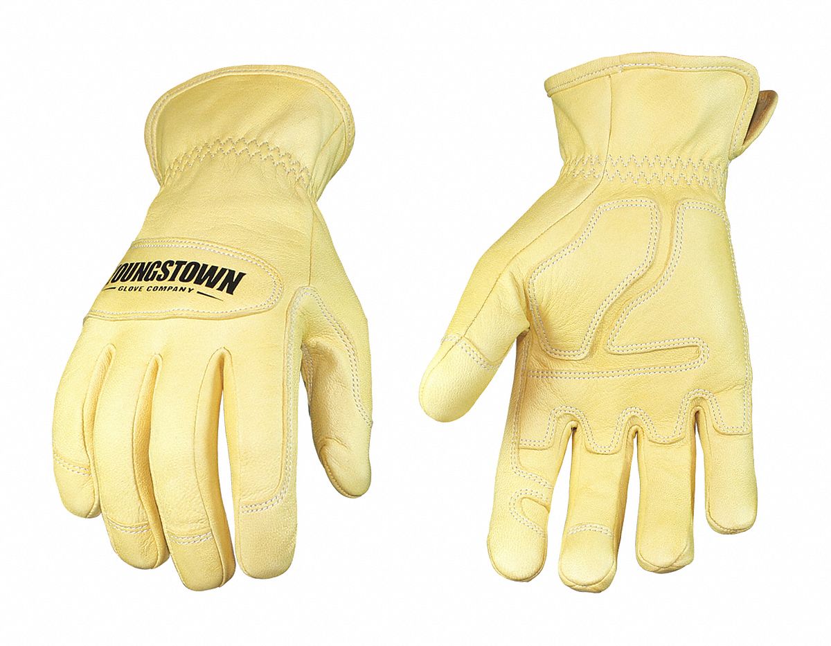

Dose any one know if these gloves are Arc And Voltage rated. I would like to find a glove that gives me better dexterity in one glove because I am wearing two gloves now (rubbers and a leather protector) and I can barely move my fingers.

If it does not list a voltage category on the gloves, I think that you can assume that they are not voltage rated. You might be able to use them in place of other leather protectors to add the Arc Flash to the voltage of the inner rubber glove. Or you might still have to use specifically listed protectors?

Funny that someone said these were not voltage rated. They say "arc flash" and give the cal. right on the glove.
Now I don't know about this, just pointing out what's printed on the gloves.

I don't claim to be an expert in details of this area at all, but protection from voltage and protection from arc flash are two different things.
You could wear stainless steel mesh gloves that possibly protect you even better then what you pictured from arc flash energy, but because they are very highly conductive are pretty useless for voltage protection as a stand alone item.
Ditto on the arc flash rating means nothing about the voltage rating. You don't say what voltage you are working but Class 0 or 00 rubber gloves with leather protectors provide AR rated protection and still provide dexterity. The rubber gloves with the leather protectors are good for 40 cal/cm2

Those gloves are rated for arc flash, not shock. From the Informational Note to NFPA 70E, Art. 130.4(B): "In certain instances, the arc flash boundary might be a greater distance from the energized electrical conductors or circuit parts than the limited approach boundary. The shock protection boundaries and the arc flash boundary are independent of each other."
Don't forget when you use gloves with an arc flash rating that the rating you typically see on an arc flash label assumes (Usually) an 18" working distance and as you get closer (Which your hands may be) the Ei gets larger exponentially so your hands may not be protected.
