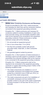

So 314.3 moves to 250.109 in 2026 and they rewrote it , while I agree the language in 2023 is what led you to believe additional bonding was required at each non metallic enclosure but that was not the case, I actually spoke to a cmp about this issue and he was the one who directed me to the 2026 250.109 and told be they re wrote it so language was in line with intent
And nothing in the rule has changed

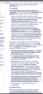

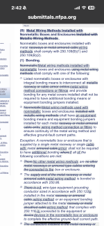

And here is 2026 , 250.86 next to 250.109(B)(1)
