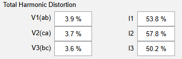

We have a weird issue, 2 breakers, a feeder in a sub and the main in a panel for some equipment. The feeder breaker is set to 300A ground fault at 0.2 second trip time, while the main in the panel is set to 1200A and 0.1 second. The main panel breaker is tripping first on GF. This is random trips while in operation and there appears not to be any ground faults on the system.
Under further investigation i see that this panel has 30-50% THD on each phase and it is reporting close to 500% TDD. Looking at the harmonics its 3, 5, 7th are crazy high and i assume these are from AC-DC rectifiers, most likely this is from VFDs or power supplies.
This is a 1000A 480V breaker, that most likely feeds several motors (single and 3 phase), plc's, and lots of other equipment. I think they are only pulling maybe 100-150A.
What would be recommended ways to solve this problem? Cap-inductor filters? Isolation transformer? Replace VFDs? Neutral-grounding resistors?

Thanks! Yeah all AC-DC machines (rectifiers) have bad 5 and 7th harmonics, so i am assuming the cause is a VFDs or power supplies or both. But for this size load what solutions do i have? I would like to give a solution tomorrow in our meeting and all i have is a big Capacitor-Reactor filter. I was wondering if there was newer tech out there to solve this issue. I think this equipment was built using cheap Chinese VFDs that are causing this problem and replacing those is a solution but i don't think we are going to go for that one.

3rd order harmonics in VFD rectifiers self-cancel. 3rd order mostly come from single phase non-linear loads, such as power supplies, UPS, electronic ballasts and LED drivers. Better load balancing can help ameliorate that.
I find that when you have a THD problem on existing systems, it’s often best to deal with it using Active Harmonic Filters. They don’t care about the source or order, they simply see and react to cancel them. Several of them now also will help correct power factor as well.
At first I was thinking maybe your system had a resonance that was enhancing harmonic currents, where power factor correction capacitors were interacting with the system inductance. But if so, I'd expect to have a higher level of voltage harmonics as well. The voltage harmonics shown seem almost too perfect given the level of current harmonics. Every L-L and L-N has the identical 1.3% amount of voltage THDv. If that's true, maybe the impedance that's driving this feeder is very low, and there are no DC link chokes or line reactors to help limit the amount of peak current from the rectifiers.
Given how high level the harmonics are, I think it could be useful to have a 'scope to look at the current waveforms, and perhaps at individual machines as well. You could see if there's any ringing or other behavior that's different than expected from normal 6-pulse rectiifers.
Perhaps it would be best to include link chokes or line reactors to reduce the current peaks, and consider Active Harmonic Filters as @Jraef mentioned which will dynamically apply currents to cancel out the THDi.
This is good advice and the active filter advice too. The white paper is mostly what i thought and is good to be able to backup my story. I looked at the other substation that is feeding this equipment and its voltage THD is not bad either, around 1-4%. Main voltage harmoics are 5 and 7th.
I think we might have some single phase VFD motors that might be the problem. I think between the white paper and the few ideas given here we have a direction to go. Thanks everyone!
