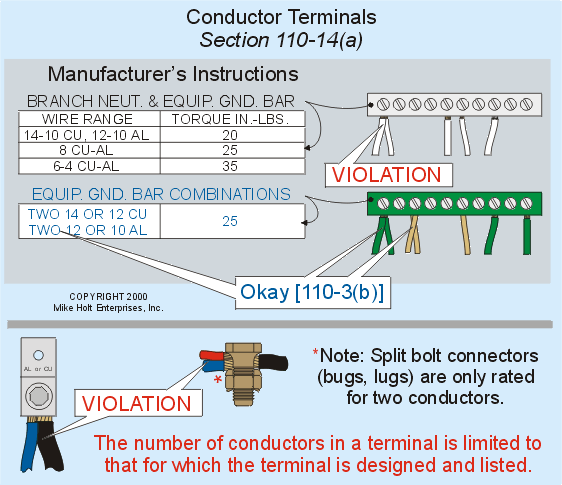

Regarding the question in the OP, I see this so often in the field that IMO it's an excellent question because some many are in the dark about the actual requirement to follow the listing of the equipment.
I have always seen bug nuts with multiple conductors coming out of it.. that was the standard method here before Polaris taps came on the market..
Good graphic.
Wow! It never occurred to me a split bolt was only rated for two conductors. Lugs and terminals yes, but not a split bolt? Guilty on this one!I'm so used to seeing three and four wire taps with them for over 25 years. It's amazing what can be learned on this forum.
Ah, the olden days of slit bolts. Back in the stone ages when some of us started split bolts were about all we had for taps in gutters. Number of conductors? ...long as you could start the nut you were good to go, and a roll of friction tape to finish it off. God help the next guy that had to get back in it. How quaint.
I think the OP's question was a fair one and of course Augie's graphic summed it up well. Lots of guys don't know these details.
