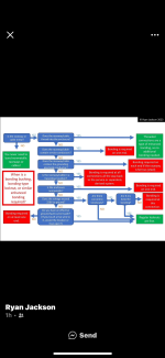

They are feeder conductors so 250.92 doesn’t apply , they would only require a additional method of bonding to comply with 250.97
Ryan made an updated version of that flow chart
Nice improvement, which ads hazardous location, and describes "similar enhanced bonding", which would include an EGC.
The only dependency is poor wording with nonmetallic raceways, which do require EGC bonding to the raceway devices.

I prefer the flow chart in post #5 but I have found that this is not 100% accurate. Bonding at only one end is not code compliant. Two enclosures over 250 volts to ground with eccentric/concentric KO's and not listed for bonding would require bonding at both ends.
