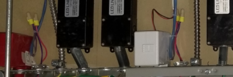

Help want to make sure this is right ?
I would have probably found a different choice for the romex connectors but that's just me.
I have a thing about romex connectors being used for unsheathed cables.
Not sure there might not need to be some separation between those LV dimming leads from the rest or not.

Where do you see Romex (NM) connectors? That is MC cable.
