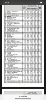

I just wanted to be sure I’m doing this correct
I have a spectrometer 240 VAC single phase 60hz nominal power 2.9 KVA 0.99 power factor, max 15 amps requiring a NEMA 6-15 receptacle
In determining the optimum wire gauge I’m thinking either #12 or #10 THHN
While using copper.org chart for area ambient temperatures I find BISHOP, CA (closest area to site) with a design temp at 100 degrees
With NEC 310.15 A requirement I proceed to derate THHN #12 AWG wire,
Table 310.15b1 with ambient temp found at 100 degrees with an insulation rated at 90 degrees my conductor derating is x 0.91
Table 310.16 #12 AWG at 60 degree (60 degree for under a 100 ampere circuit or within 14 to 1 AWG conductors ) rating is 20 amperes?
Therefore 20 amperes x 0.91 = 18.2 ampacity for # 12 AWG after correction
However, receptacle circuits are not to be loaded over 80 percent.
Therefore 18.2 i x 0.80 percent = 14.56 amps usable on circuit, which is under 15 amps target
Therefore am I overkill to go up to next size #10 AWG?

No, stop there. When applying the 0.91 you use the 90C rating of 30A, to get 27A. Then if your equipment has 60C rated terminals, you take the lesser of 20A (the 60C unadjusted rating) and 27A (the 90C adjusted rating), and you get 20A.

Why are you using the 100 deg adjustment... is the lab temp 100 deg ?? :)
No but from my understanding NEC requires conductor ampacity adjustment/ correction for geographic locations other than 85 degrees Celsius.
Based on copper.org chart, Bishop, California is rated with a “design” ambient temperature 100 degrees Celsius. This temp exceeds the NEC conductor ampacity table with 3 conductors or less based on an ambient temperature of 85 degrees celcius
Some people would probably just tell me to skip this step, but I do it for my knowledge especially to take future journeyman license testing

The adjustment is for the ambient temperature for the environment where the conductor is installed not the outside temperature.

My bad I had not placed a ruler under chart so I got 25i instead of 30i for #12 AWG THHN wires
New calculation hopefully is 30i x 0.91 (temp derating) = 27.3i
27.3i x 0.80 (conductor bundling over 3 conductors 2 designated circuits in one 3/4” EMT) = 21.84i
21.84i x 0.80 percent rule for branch circuit = 17.47i
Looks like I can go #12 AWG THHN like you said and hopefully I did this correct at last?
(a) The 80% you reference is in 210,23 "multi-outlet branch circuits". Since you have 1 piece of equipment you can make it a single circuit and use the receptacle at full load
(b) IF you want to apply the 80% rule, your load is 12 amps (2.9kw/240) which is only 80% of a 15 amp circuit.
(c) #12 is fine but #14 (25 X .8 = 20 amps) on a 15 amp OCP device (240.6) would be Code compliant
Just to reiterate what Augie said, for an individual branch circuit, in conditioned spaces, neither the 80% limit nor the temperature correction apply. It's as simple as "non-motor load <= 15A; use a 15A breaker with #14 wire."
