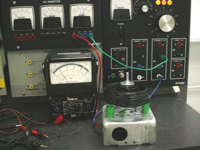

Being inquisitive, I performed the following experiment:

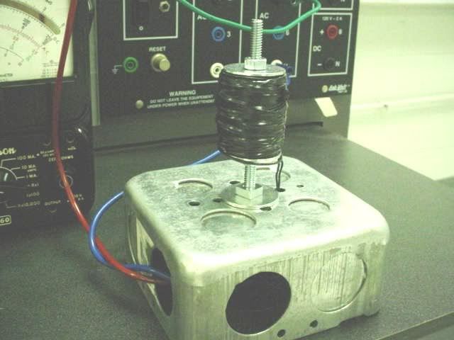

First, I built a primary out of a 1/2 rigid coupling, a long 1/4-20 bolts, a couple fender washers, and about 200 turns of #22 insulated wire. I wrapped the coil with electrical tape to hold the wire on. I mounted this on a 4-11/16 box.

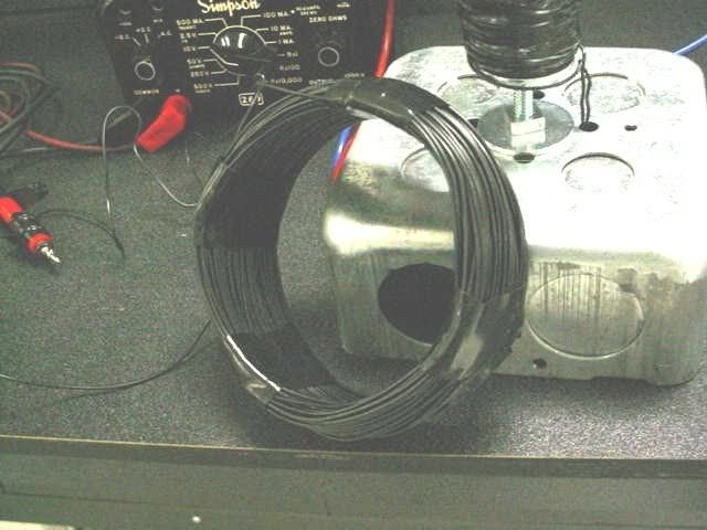

Then I wound a secondary of about 4" diameter with about 200 turns of the #22 wire.

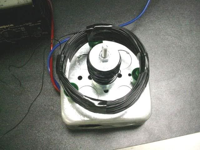

Next, I placed the secondary over the primary and supported it with plastic dry-erase marker caps.
Then I connected a variable 60Hz AC source to the primary. I used a Simpson analog meter set on the 10 volt scale. I increased the primary voltage to a level that put 6 amps in the primary. The built-on panel ammeter read 6 amps. The Simpson read 2 volts on the secondary as evidenced in the photo below.

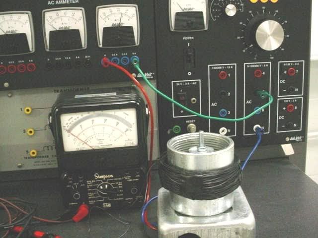

So far so good. But then I took a 2 1/2 inch rigid coupling and placed it between the primary windings and secondary windings. The current on the primary was still 6 amps. The voltage on the secondary fell to zero (or very close to zero as far as I could tell.) This is evidenced in the photo below.
Note that the photos are from the actual experiment. I did not cheat in any way. This really happens. Try it yourself.
Now what can we say about Faraday's Law concerning flux density in the loop? The same amount of current is flowing in the primary in both cases. Doesn't this imply the same flux density? What do you "flux density" guys have to say about this?
I'm pretty sure I know what is happening. Any thoughts?

I am not a 'flux density' person, but a 'net flux enclosed by the loop'.
If you assume constant flux density over a given area, then the flux enclosed by the loop is simply the product of flux times area. So to the extent that flux density is constant, I am a flux density person. I'm also happy with integrating flux density over an area to claculate net flux.
But if the flux density is not constant, then you need to figure out some way to calculate the total flux enclosed by the loop.
With the transformer that you set up, the total flux enclosed by the secondary was equal to the flux flowing through the 'core' (the 1/4-20 bold) less any flux that returned via the air between the primary and the secondary. Imagine a plane defined by the secondary coil. At the center of this plane you have a steel core with flux flowing 'up' out of the plane (at a given moment in time), and everywhere else in the plane you have much lower flux density flowing _down_. Since flux always travels in loops, the amount of flux flowing 'down' through this plane must equal the flux flowing 'up'. The flux enclosed by the coil is the sum total of the flux flowing up inside the coil less the flux flowing down.
When you put the 2-1/2" coupling inside the secondary, you provided an improved path for the flux flowing down, but _inside_ your secondary. More of the flux through the core is balanced by flux returning, so that the _net_ flux enclosed by the secondary is greatly reduced.
If you remove the 2-1/2" coupling from inside the secondary, and add a larger coupling on the _outside_ of the secondary, then you will see the voltage go up.

With the coupling in place, the outer loop is no longer being cut by lines of flux. They are trapped within the coupling. You have created a shield, not a means of coupling the magnetic fields associated with the two windings.
Take a look at the way many transformers are built. A ring of metal has the primary wound around one side and the secondary wound around the other side. The magnetic field generated by the primary current is transfered via the metal to the secondary windings. Such fields "travel" better through metal than through air. It is in this sense that the two windings are "coupled" by the metal core.
Your experiment does not couple the windings in the same sense. The primary is not wound around the metal, so the metal will not serve to carry the field to the secondary. That tends not to matter, because the secondary is not wound around the metal either.
You have proven how a faraday cage works.

Your primary flux path goes through air to get from the top around to the bottom of the coil. In your initial experiment, a lot of the flux went outside the secondary coil so that there was a net flux inside the coil, inducing the measured voltage.
In your second experiment, you provided an easier path for the flux to get to the bottom of the primary coil by putting the steel coupler in the path. Now, practically all of the flux goes through the steel coupler so that the net flux inside the secondary coil is nearly zero (one direction in the bolt and the other direction in the steel coupler).
Your flux is in circles going through the center of your first coil, out, around, and back through the center. (Remermber, flux lines are always closed loops. Even if it loops out to infinity and back again.) Some of the flux lines return inside your second coil, and some return outside the outter coil.
When you insert the 2" coupling, almost all the flux lines return back around inside the coupling. So the "net" flux inside the coil is reduced to almost zero.

Great explanations from everyone, and exactly what I had figured out myself.
Just to reiterate what y'all said:
From a "flux cutting conductor" perspective, the metal coupling acts as a shield, trapping the flux into the coupling and preventing the flux lines from cutting the secondary conductors.
From a "changing flux density in the loop" perspective, the flux lines in the primary core are going "up" while the flux in the coupling is going down, and they cancel out as far as flux density is concerned. Therefore, there is no changing flux density within the secondary loop.
