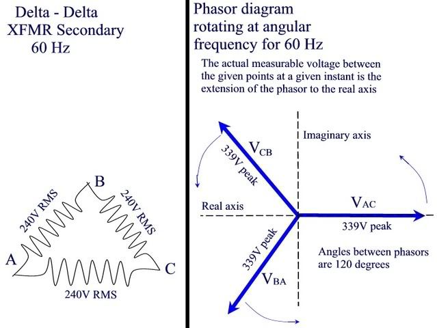

Okay... this is my thought on what the rotating phasor diagram for voltages for a 240 volt RMS delta secondary should look like. Am I messing something up? Right now, it makes complete sense to me. (until someone tells me it is all wrong:mad: )
Henry Higgins
Henry Higgins
By George, I think he's got it.

I have seen the diagram indicating Vpeak instead of the actual 170 volts or 339 volts as I have shown. One thing I don't understand... if we use the RMS values in a rotating phasor diagram, then as the phaosr rotates, the projections onto the real axis cannot be the real and correct voltages at various points in time. I would think that a RMS phasor would be a static vector, and not rotating. I would like to better understand the application of the RMS phasor. You can't really rotate it and get any meaningful results without applying a multiplier as rattus has indicated?
On the other hand, if we indicate 120 volts RMS, then for a sine wave voltage, this leads to 170 volts peak, so as long as we use the peak, we can label the phasor 120 v rms. The magnitude in actuality is still Vpeak?
Correct. Most of what we are going to see here is the RMS value. I usually don't see a "label of RMS" but that would be the clearest way to do it. Shorthand can lead to a misunderstanding. Most books start out with a "conventions used" section, then use the shorthand.
Most people know 120 is RMS. If you had a phasor with the label "120@0" most would know this is rms. If you put "170@0", I bet most would do a double-take.

To nit-pick: The magnitude of Vrms is the positive value of Vrms. The magnitude of Vpeak is the positive value of Vpeak. The maximum value of the wave represented using the Vrms notation is Vpeak.

First off, you are showing a wye diagram. Connect all the arrows head to tail to form an equilateral triangle.
Second, these are static phasors and their magnitude is 120Vrms. It is confusing to provide peak values.
Yes, the head to tail connection of the 120V phasors is correct, but it is not the only correct configuration.
don't confuse circuit and phasor diagrams
As for the phasor diagram, an open-type phasor diagram is the preferred method. Also, don't get confused and mix a phasor diagram with a circuit diagram. They are not the same thing.
A closed-type phasor diagram may LOOK like the circuit diagram but a circuit diagram and phasor diagram serve two different functions.
