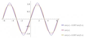

I am having an issue at my residence where there is significant harmonic distortion and I believe the cause of my UPS constantly alternating between battery and line power. The issue has occurred ever since we moved into our house back in March although has been progressively worse the past month and a half. Through monitoring of both the UPS and a Fluke 179 I noted voltage and frequency were all within spec and could not determine any anomalies. My utility company even put in a recorder to monitor at the meter and did not see any anomalies over a 3-4 week period either (as far as I can tell it was just measuring voltage and load).
I then came across harmonics and began to dig into that. I went around my house and at the outlet (dedicated 20A circuit that was recently run) to the UPS I measured THDv% between 9.1-11.4%. I went downstairs to my breaker panel, turned off the master switch, and still measured 11.1% prior to the switch:
The third harmonic seems to have the significant amount of distortion when I go through the first 25 harmonics. This morning, I measured and at THDv 9.8% I have the following:
h01 - 100%
h02 - 0.0%
h03 - 9.7%
h04 - 0.0%
h05 - 1.8%
h06 - 0.0%
h07 - 0.4%
h08-25 - 0.0%
As far as the UPS is concerned, I've taken it and run it for 15 minutes at a couple neighborhood homes (within a 3 mile radius as the crow flies) and a couple commercial buildings. The two other neighborhood homes that, like mine, have a single phase feed also exhibited issues. Similarly, when I measured THDv at one of them it was also in the 9s. The Starbucks down the road the UPS was on line power the entire time and THDv there was 2.6%. That is fed by a three phase padmount transformer.

Here's a plot of the effect of having a 9.7% third harmonic level with a polarity that reinforces the peak, and also the opposite polarity that flattens the peak. It's also possible to have the third harmonic phase shifted such that there is asymmetry in the waveform. The fundamental content is the same in these plots, but the waveforms of course could be scaled to keep peak level the same, RMS the same, etc.
You might look at your line voltage with a 'scope if you have one available.
There is no real reason that a UPS could not work effectively with this level of harmonic distortion, but I have no idea what your UPS requires.

Unfortunately, neither do I yet though I've asked the manufacturer. I have noted that on the rare occasion THDv% is measured at 8.9% the UPS is more stable (though will fluctuate every several minutes or 15 minutes or so). When it gets into the 9s and higher it's a near constant alternation. When on the test sites with <3% THDv, it had no issues.
I forgot to answer the post above, I have monitored voltage by watching a Fluke 179 and the UPS itself keeps a running log of both voltage and frequency. Nothing was out of accepted range, voltage measured maybe 119-123V while frequency measured 59.89Hz at the lowest to 60.00Hz.

Take a scope pic of your CURRENT waveform, and the voltage, and post that. Can sometimes tell from that which neighv=borhood loads are the culprit.
My guess is that someone (or you) have a cheap inverter on something running -akak cheap means simple diode rectifier in front end. examples are cheap bitcoin miners, induction cooktops, some washing machines, etc.
