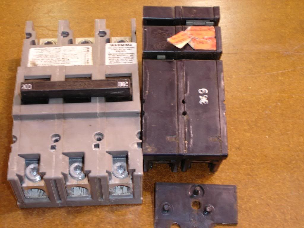

Milbank bought Unicorn Industries which made MH park pedestals, & other equipment for RV's and the like, they made a Zinsco based"Pick N" Amp" breaker where you changed a rating plug rather then swap the whole breaker if go from 100A to 200A or the reverse, was a good idea but poor execution because of being based on Zinsco. (Off topic, but Milbank controls the Wadsworth name).
The 3 pole breaker on the left is a Milbank Zinsco clone.
Closeup of the rating plug.
Thanks for clarifying. I knew there was more to the story as to why there's weird looking breakers in Milbank meter mains. :sick:
