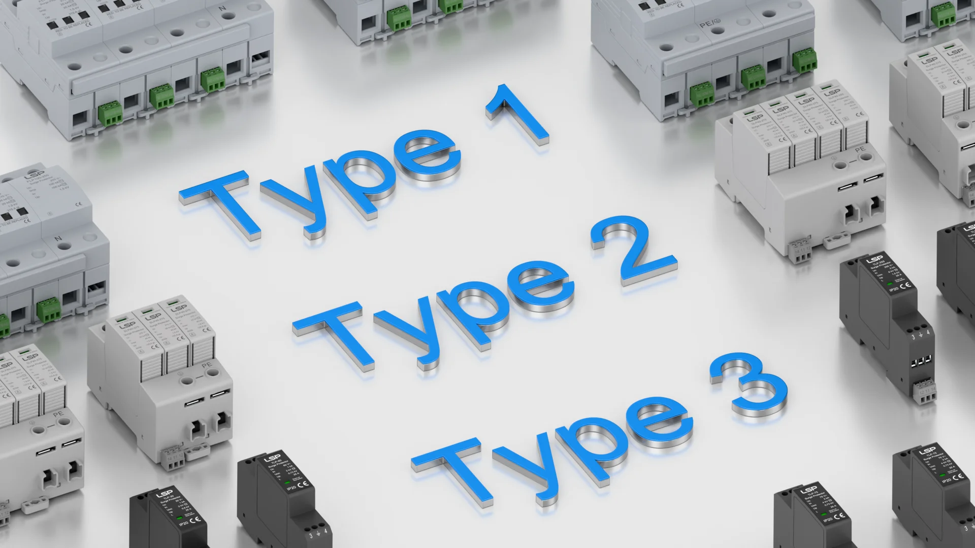

Originally I thought that my Type 2 SPD made a Type 1 SPD redundant since I installed it directly after the main disconnect in my GE combo meter/load center panel.
But after looking into it more, it seems Type 1 SPD have a different Rise Time and Duration than Type 2 SPD.
Thank you for pointing out that I should look into getting a Type 1 SPD as well.
  • Type 1: (10/350 µs) 25kA to 100kA
  • Type 2: (8/20 µs) 20kA to 75kA
This article gave me a great breakdown of the differences between the 3 types of SPDs:
