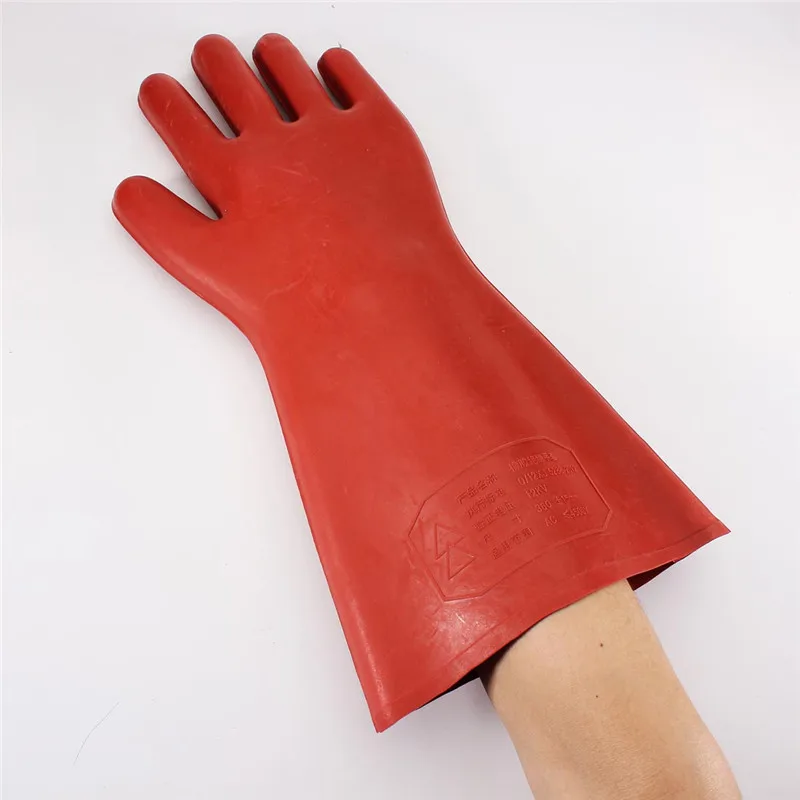

lots of plastic & rubber. being bonded is "safe" ;)
3XRG3_AS04
NEW-1-Pair-Insulating-font-b-Gloves-b-font-Rubber-Safety-Electrical-Protective-Security-Safely-font.jpg
