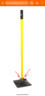

We are tasked to put 32 feet aluminum pole total with 25 ft above, 7 ft will be below grade and will be encased in concrete. After digging the 36 inches in diameter and 7 ft deep using an auger, the base soil look really loose. How do we go about compacting the bottom of hole? I doubt any equipment (wacky packer, vibratory sled) would fit in there. I was thinking of using a hand tamper, tying a rope at the top of the handle then drop it in the hole and start compacting it that way. I don't know if that is enough though. Any recommendation?
I would think the the weight of 7' of concrete would be enough to compress whatever loose material is in the bottom of the hole. Otherwise a heavy kettlebell on a rope dropped repeatedly into the hole would do it.
You can buy a manual pole tamp with an 8' handle like we have, but your not in the business of needing one a lot.
Get a piece of metal, say 3/8" or 1/2" thick and weld a handle on it.
