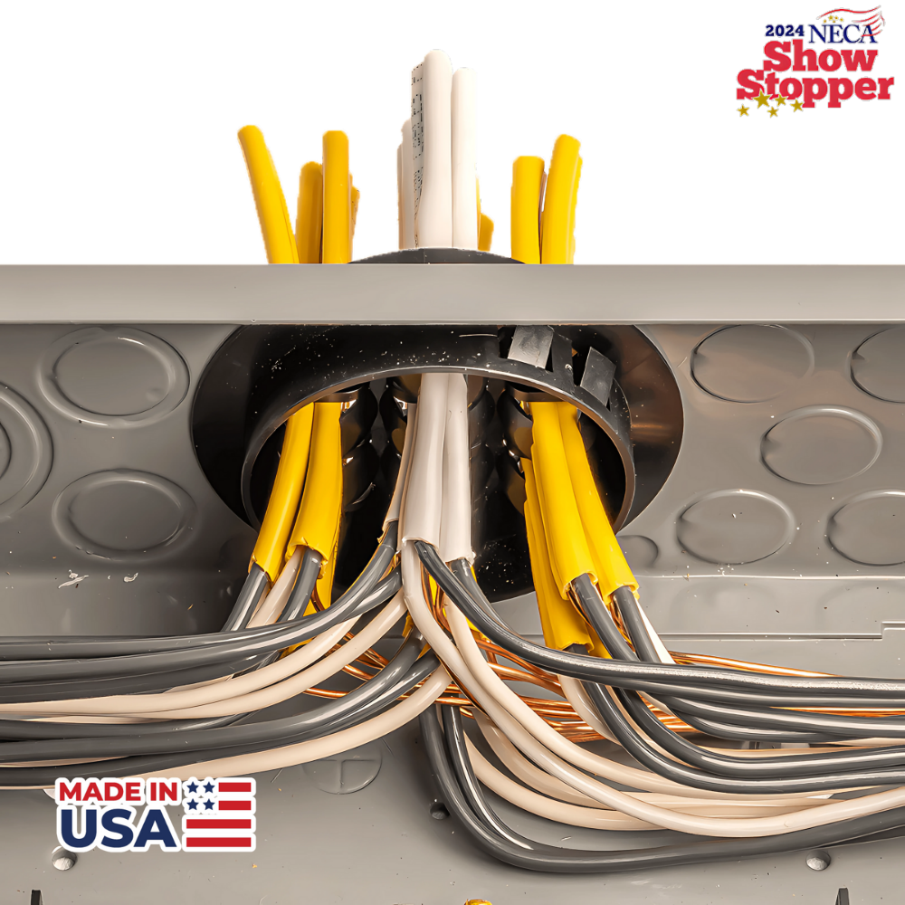

We're working on a DADU where we are wiring everything with NM cable and using an exterior surface mounted meter/main with distribution. What is a compliant way to enter the enclosure with ~22 circuits? I just read through this thread, I'm not sure there's a great option. The cabinet has two 2.5" KOs, so what I want to do is use a 2.5" PVC TA, staple within 12", run most of the cables through the TA, and duct seal it, but it seems pretty clear that's a violation. I like the idea of a TA because then waterproofing the penetration seems more ideal since it extends past the building envelope. I also found this Wire Waffle from Rack-a-Tiers which seems like it would work but then waterproofing seems hard. I could swiss cheese the back with a bunch of field cut KOs, but again, waterproofing.

IMO using something like the Wire Waffle is the only code compliant way to bring multiple cables through a single KO. If you watch YouTube you'll see thousands of videos where a chase nipple or terminal adapter is used so I'm guessing that in many jurisdictions they have accepted this method although it is specifically prohibited by the NEC.

What do you think the best method to water proof the Wire Waffle would be?

As Infinity said, just put a heavy bead of caulking on the back of the panel around the KO's. Not really any different than sealing around a TA.
We also usually put a bead of caulk around both sides and the top of the panel once its mounted.
