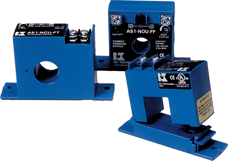

Your original solution was overthinking this and suggested he was trying to control speed. His end purpose isn't to measure current. He wants to stop a motor once it hits a certain current draw. You don't use a bench top ammeter to do this. You don't measure the speed, attach an oscilloscope, or create a table of current vs speed. You use a Hall-effect transducer, pick a cut-off current and a relay and package it onto a circuit board.
