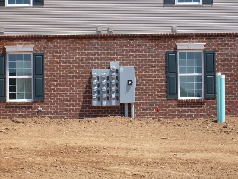

mdshunk said:
I promised some pictures of some 16 stacks. The CH equipment is about the most compact you're going to be able to get your hands on. Here's a few, most 16 stacks with an owner meter:
That ditch is to shallow
A picture is not always a good way to judge the depth or width of a situation.
If you were to look at where the grade level seems to be final, it is by the brick/concrete level. From the looks of it that is above the gentlman's knees. I would venture to say that is more than sufficient as per Table 300.5.
In our neck of the woods, I know that Marc is considerably south of us, there would be a requirement for expansion couplings as per 300.5(J).

mivey said:
Now if this were a new complex, and a 3-phase line were there, we might spec the service different. The builder is supposed to coordinate with the POCO, although they don't always do it. Sometimes it costs them money, sometimes we can work around the problem. The POCOs are not always so Draconian.
In the example of Marc's meter stacks, if they were to be installed under the POCO's here, they would tell us they are to be fed 3-phase. End of story.
