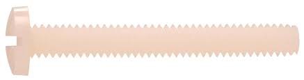

Exposed 832 screwsIs there a box on termination end of K&T designed for K&T? if not good luck finding insulators. Seen many that are just flying splice or improperly put into a MC box with no insulators.
Porcelain Keyless fixture?
For holding a ceiling fixture I think you'd need something rated for the 50lbs. For a wall keyless I think that'd flyHa-Ha!: Nylon screws!
