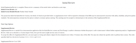

This afternoon, I received word that I've now failed the "initial review" - which must be the same as the step 4 engineering review. Or at least part of it. Here are their comments:
The more detailed section points to the red circle below...
Section 3.4.4.1 through 3.4.4.3 can be seen here, just ctrl F 3.4.4.1 and it will show you...
https://www.xcelenergy.com/staticfiles/xe/Regulatory/Regulatory PDFs/rates/MN/Me_Section_10.pdf
OK, so TLDR, it seems that i'm now at a position where Xcel wants to do additional reviews of the grid and my property to evaluate if the size can be installed "safely". The $200 deposit is a placeholder, that gets them started, and then i'll be on the hook for whatever additional fees they want to throw at me -- Plus whatever remedies need to take place to allow me to move forward. The DER Size on Shared Secondary is interesting, i'm not sure what that means -- any thoughts??

If the proposed interconnection passes the supplemental screens in sections 3.4.4.1, 3.4.4.2, and 3.4.4.3 above, or if the proposed interconnection fails the screens, but the Area EPS Operator determines that the DER may nevertheless be interconnected consistent with safety, reliability, and power quality standards, the interconnection shall proceed as follows:
it is almost as if they just want someone to approve the size and the lines to the sub station?
FYI - i already paid the $200 deposit, and am going to see what happens next..

Your drawing shows a very, very large system for a 200A service so I'm not particularly surprised you're getting kick back at this stage.
This may be out of date but a few years ago I read that PG&E would approve any system interconnection less than 5kW without doing an extensive engineering review. Anything higher got looked at by engineering. So that may be all they are telling you at this stage. Still, our customers often have to wait for transformer upgrades if there's more than about 15kW of systems connected to a shared transformer. Sometimes less. Yours is more. Around here we can interconnect up to 30kW and they can't charge the customer for network upgrades on a shared transformer, just make you wait for it (months if not more than a year). The rules may not be so lenient in your state.

Yep. It is pretty large for a home gamer around here. But the system you apply through. And the xcel solar rewards program basically call out 40kw as the max size where you can follow the fast track process
I’m down for the engineering review. But like you’ve said, it’s a large system for a 200a service. But. I have two 200a services on the property. So it’s not that crazy. Their system doesn’t really give you the ability to explain that.
Hoping the engineering review they will actually reach out??
I just don’t fully understand how I could theoretically utilize 400a of service to my property. But can’t generate 120a. lol.
The utility is not obligated to install infrastructure on their side to constantly supply 200A and they typically don't, especially for residential. They will size a transformer to what they think will actually be drawn, and they won't mind if it gets overdrawn a few hours per year. The max output of a solar system that offsets x amount of energy per year is typically 5-7 times the annual average power of that amount of energy, and a large percentage of that energy output happens continuously in the summer for many hours straight. I other words you are installing a 26kW system for someone who possibly never uses much more than 4kW, but uses that steadily and consistently. Or more likely the reality is somewhere in between, but the point is that the transformer could very well be taxed by the backfeed in summer in a way it is never taxed by the load. This, among other things, is what they'll be looking at in their review.
