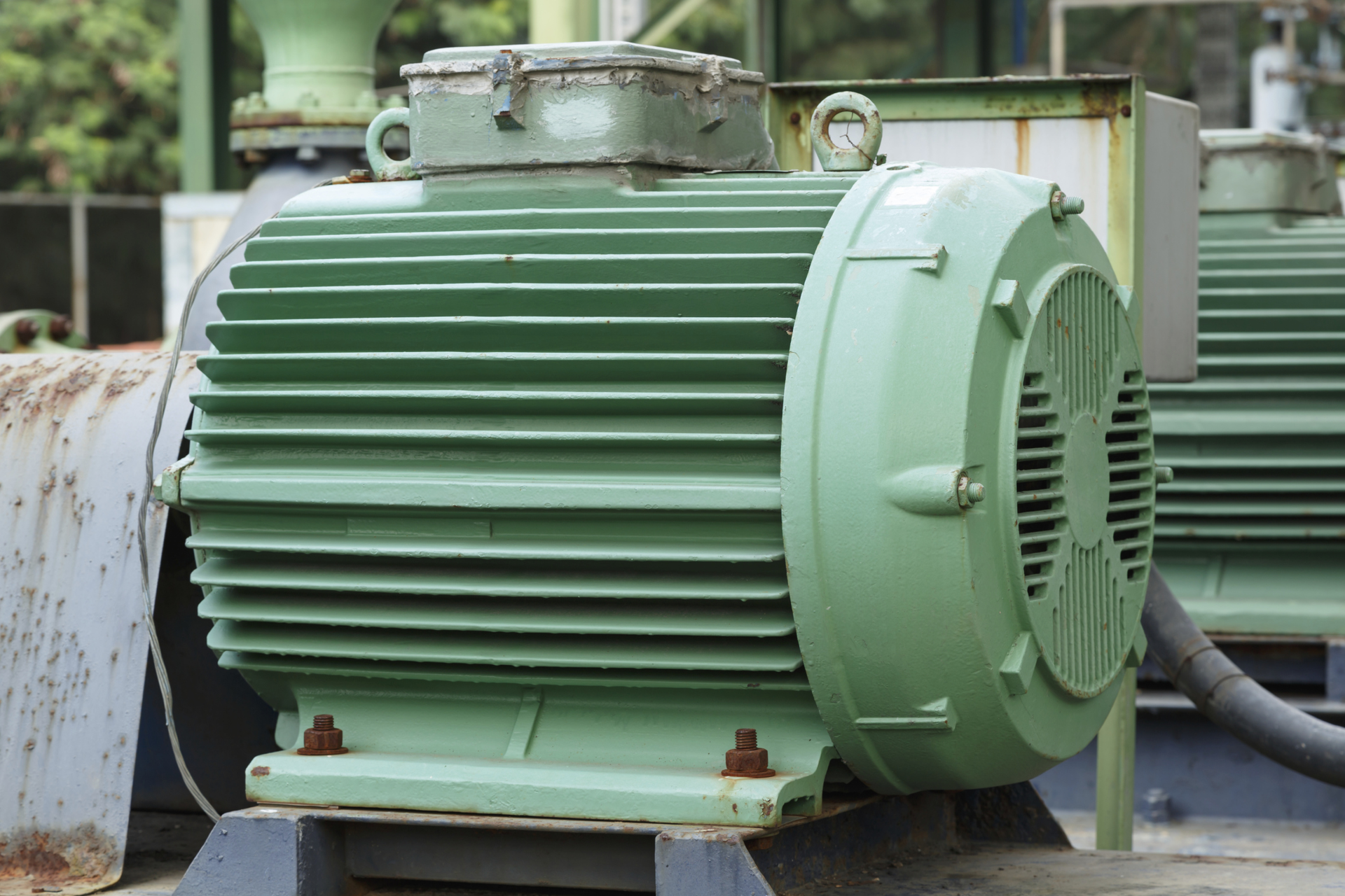

Voltage unbalance on the service while the dust collector is not running is 1.02%. Technically, it exceeds NEMA standards, but only by 0.02%.
Voltage unbalance with the dust collector IS running is 0.95%.
Using the my motor's FLA of 222A, unbalance is only 4.58% while running.
While starting, motor current unbalance is only 0.49%.
Indiana
I'm at a loss as to where to proceed next. The customer had a new and unused 400A circuit breaker in a new service that we installed a few years ago, and that did not resolve the starting overload. I've been attempting to hire a local company with motor circuit analysis equipment, but their communication has been basically nonexistent.

A few more things come to mind. What settings are on the 400A breaker? How are the bearings on the motor and on the fan? Is the fan belt driven? How do the belts and sheaves look? Can you disconnect the fan and get a current draw to compare? When disconnected, does the motor and does the fan spin easily?
A little voice in the back of my head is whispering: "It ain't electrical."
Fred B
Upstate, NY
Thinking the same. Mechanical issues will cause a significant rise in starting draw, Bad bearing or even debris getting into the vaccum from missing or mis-aligned filter will create a large spike in startup current to exceed the trip curve of the breaker. Manually turn the motor should give an idea if this is the problem.
