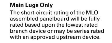

This is where my confusion comes in: when i look at their cutsheet for eaton PRL1X: So they are saying: your main lugs only panel for this can be rated based on the lowest branch breaker KAIC.

That still mentions series rating with upstream device.
I looked at info on Square D panels (that I have more familiarity with) they pretty much say the same thing.
They have a table listing integral main/upstream breaker types (all Square D breaker types) that are series rated for use with the panelboard and also mentions fuse types that are series rated.

This is what the Eaton catalog says about this:
So if every breaker in the panel is rated 22kA, the panel is. Now, you may run into an AHJ saying that you need to prove this, because of the label ON THE PANEL not saying that. So I would suggest having this page out of the catalog printed out and ready for inspection time, or clip that statement and paste it on there with that catalog at the ready.

Label in first image in OP says 10kA, unless upstream device is series rated with the devices in this panel.

Doesn't the phrase "Through Feed And Subfeed Panelboards" refer only to the case where the incoming conductors supply outgoing conductors without going through an OCPD, through an extra set of lugs on the far end (through feed) or near end (subfeed) of the bus?
In which case, if you're not doing that, the note is not material.
Cheers, Wayne
Spot on! After going back and forth on this. That was the conclusion of what they meant on that label sticker. Basically if your panel not series rated with main breaker or a series breaker upstream, then the panel KAIC is based on your branch lowest breakers ratings. In this particular case all the branch breakers are rated for 22kaic and there was no series rating with an upstream breaker. So this made the rating for the panel fully rated at 22KAIC.
