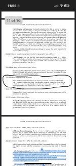

I had the following useful discussion a couple of years back on a similar topic where the conclusion was that #6 NM on a 60A breaker was not code compliant
I was today sent this note from the NJ which comes to the opposite conclusion
One of the more frequent questions we get in the Code Assistance Unit relates to the use of Non-metallic sheath (NM) cable for EV chargers. Specifically, the use of #6 CU on a 48-amp load. There appears to be a significant portion of code officials with a difference in opinions on how we should apply the requirements found in Article 625 of the National Electrical Code (NEC), with continuous load designation and NM cable. First let’s start with Article 625; Article 625.41 requires the overcurrent protection device (OCPD) to be sized for “continuous duty,” thus applying a factor of 125% to the full load of the equipment. “Continuous Duty” is a term used to alert installers that considerations must be made to help dissipate excessive heat when a substantially constant load is present for an indefinitely long period of time. This increase is a “cushion” to help the circuit components deal with this heat. There is NO additional current on this circuit.
Table 310.16 of the 2020 NEC shows 6 AWG having an ampacity of 55 amps at 60°C (See 334.80 for ampacity limitations). "Ampacity," as defined by the NEC, is “The maximum current, in amperes, that a conductor can carry continuously under the conditions of use without exceeding its temperature rating.” Based upon table #6, NM can safely carry 55 amps WITHOUT exceeding the temperature rating of the conductor at 60°C. Considering most devices and OCPD’s have dual rated lugs with temperature limitations of 60°C/75°C, limiting the ampacity to 55 amps or less will inherently limit the temperature of any device to be well within its listed operating temperature. Which means, applying the 125% to a conductor which is already limited by 60°C does nothing more to protect the equipment or the conductors in the circuit. In the 2020 NEC, a change to Article 334.80 was made from “allowable ampacity” to just “ampacity." This change seems to imply that the ampacity safely carried by NM cable is dictated by the actual load and not OCPD. Furthermore, the provisions of Article 240.4 for applications under 800 amps do not exclude NM cable. Therefore, the opinion of the Code Assistance Unit is that #6 NM cable should be permitted to be utilized for EV chargers with loads not exceeding 48 amps. Source: Scott Borsos Code Assistance Unit (609) 984-7609

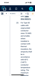

My state amended 334.80 and nm cable is only restricted to 60c ampacity when it’s run in contact with thermal insulation which in residential ends up being most cases , but the amendment is beneficial allot of the time when wiring evse with panels in unfinished basements/garages and hardwired evse located in those garages or on the outside wall of garage , and since most if not all hardwired evse is marked 75c ,so we can terminate 6-2 nm at its 75c ampacity in accordance with 110.14(c)(1)(a)(3) and it’s compliant for 60 amp circuit for hardwired evse
You can get copper SER 6-6-6-6, it is less costly than 4/3 NM, but a lot more than 6/3 NM would be.
You would only need SEU for hardwired evse, they don’t need a neutral
My state puts the same restrictions on se cable as nm though when run in contact with thermal insulation
338.10(B)(4)(a)(3) is amended and all SE cable is restricted to terminate at 60c ampacity when run in contact with thermal insulation.
So if it’s passes through a insulated wall SE cable would not be a option here for a 48 amp hardwired evse
Would need to be # 4 nm cable or a #6 75c wiring method (mc/thhn)
I should take whomever voted for that amendment on a tour of a SE cable pant, SE cable is made with cross-linked polyethylene (XLPE) insulation type RHW per UL 1581 which has including superior heat and chemical resistance, high insulation resistance, and lower dielectric losses its nothing like the cheap PVC used in NM cable.
SE cable is definitely designed and tested for 75C even when in contact with run in contact with thermal insulation.
Yea man you’re correct it definitely is I’m not a fan of the amendment either , they remove the NEC language of ungrounded conductors #10 and smaller and make it a general rule for se cable , although i will say I’ve never seen it enforced and I tend to ignore it as well
