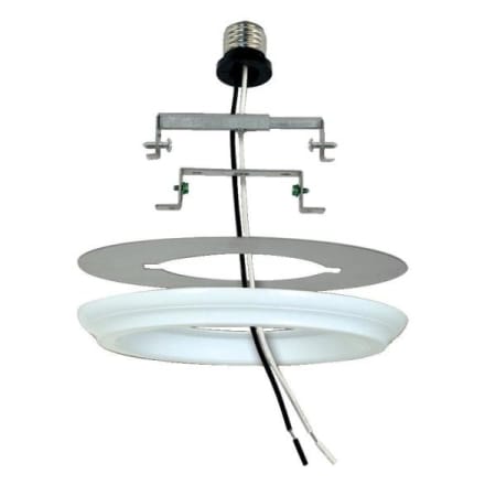

On a renovation, owner wants to replace a chandelier. So far no problem. Current one had what looked to be a medallion on ceiling. But when I removed the existing hanging fixture found it was not a medallion but was the trim ring from a recessed can light, an octagon box mounted inside of can. The existing fixture was very light weight but new one is more of normal for a chandelier. Haven't taken it apart any farther but I would assume that a fixture box mounted to a recessed can interior is not capable of supporting the chandelier at best and a violation at worse. Question is it a code violation? And if so what section?
