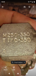

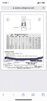

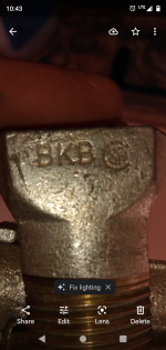

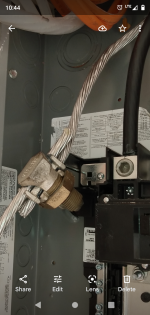

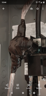

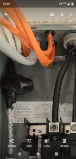

You could just tap a lug into the panel and terminate at the top of the box.View attachment 2562413 un the field right now,. We grabbed a split bolt to extend a ground in a panel that was cut too short. Instead of just blindedly usung it, I looked to see if we could use it for aluminum wire. I don't think we can
Keep up the good work and paying attention. You’ll go far by challenging yourself to do things correct and not just going along with the common Joe.I didn't think of that, I did however let the office know about it. They are sending a crew back to fix the issue and were glad I caught it.
