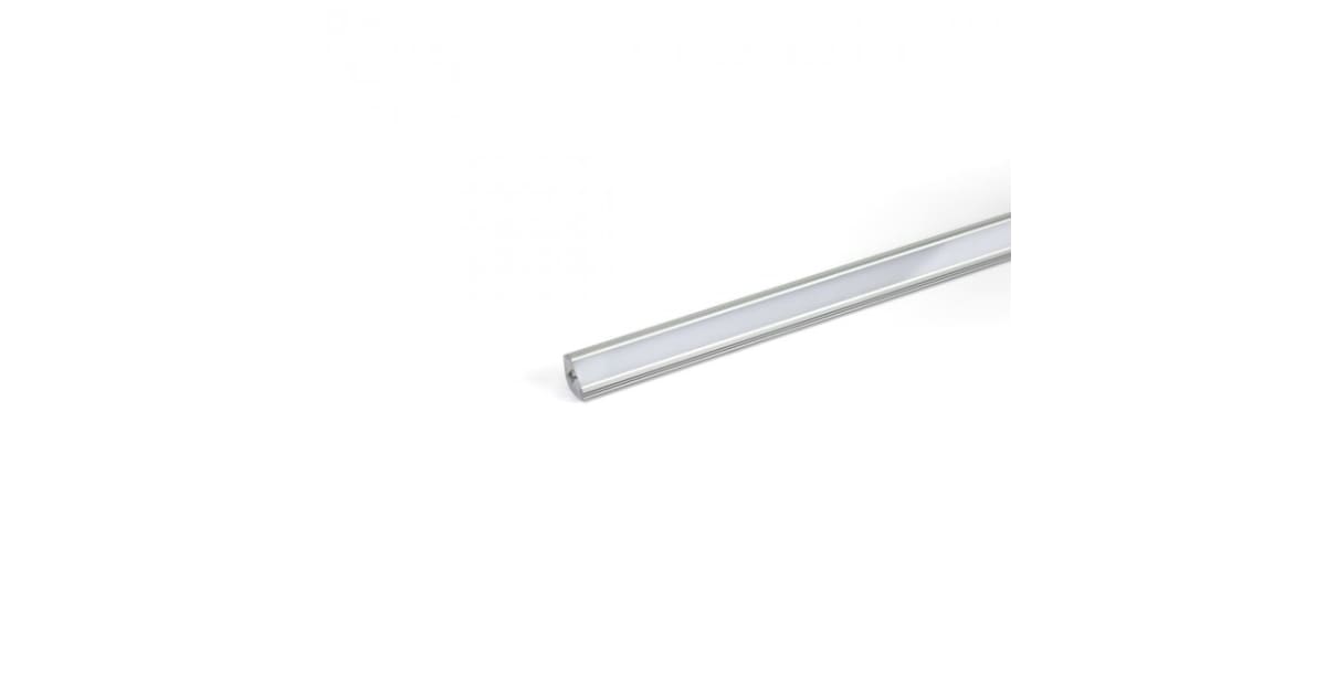

Personally I like these. They are higher end on cost side but work well, dimmable, and lighting source and mounting is totally invisible from rest of kitchen area, have to actually get head up under cab to see when mounted behind cab front face with as little as 3/4" drop of face below bottom of cab. Zero shadowing and full lighting of work surface under cab. Driver and tape sold separately choose a size to your needs.
Do like the option that @James L mentioned in his post and might consider that with the WAC Tape channel cover LED-T-CH2 from WAC for cost saving.
I love the 45° angle approach. I’ve always used a similar track, but never the angled one, I think that would be a nice touch and worth pursuing. Thank you! Happy with the feedback I’ve been getting. Always looking to make my next install better than the last
