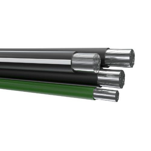

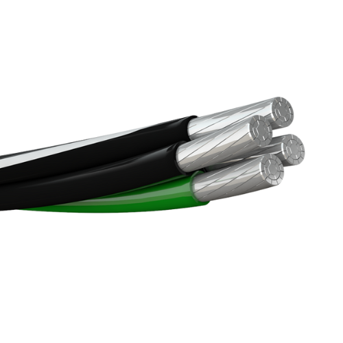

4/0-4/0-4/0-2/0 "Wakeforest" is common around here, but is primarily used as service conductor for three phase.
Cable marketed as Mobile home feeder cable likely is 4/0-4/0-2/0-4.
I've never seen a mobile home feeder cable with a 2/0 EGC.
For sure no box stores around here carry that. Why would you need that size? A #4 is all that is required for a 200A service/feeder.
I too have wondered why such a large EGC is used, never really could come up with a good answer, but there it is.
Maybe someone with a good contact inside Southwire could get an answer that question?
Southwire's website says "Southwire® mobile home feeder consists of four quadruplexed type RHH or RHW-2 or USE-2 Alumaflex® Brand AA-8000 series aluminum alloy compacted conductors. The cable contains 2 triple-extruded phase conductors, a white striped neutral conductor and a green grounding conductor to eliminate the need for field marking per the National Electrical Code. The insulation is sunlight resistant."
They offer both 4/0-4/0-4/0-2/0 and 4/0-4/0-2/0-4 but don't suggest which is applicable when.
I'm not educated to know; out of my ex-electrical functions.

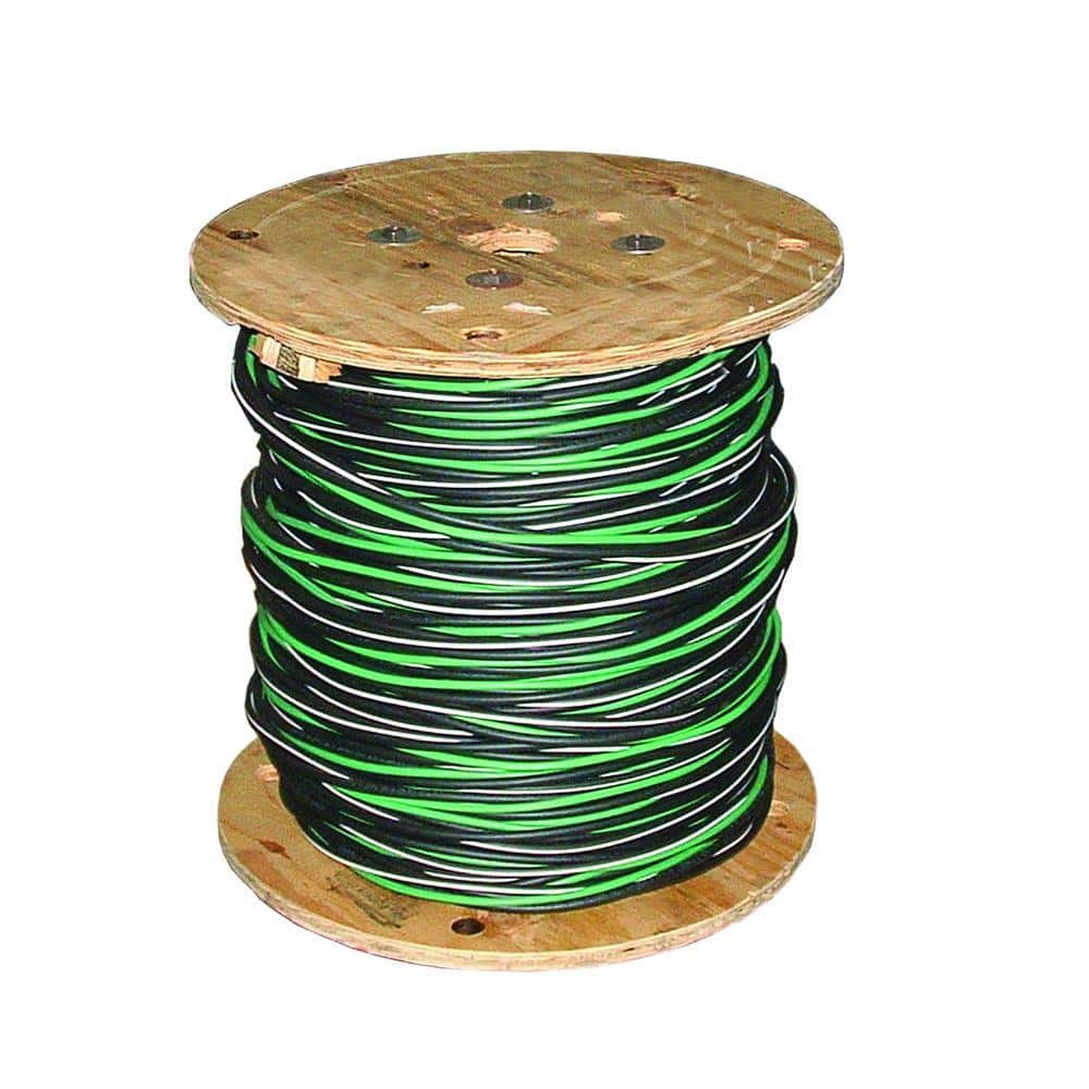

There is many options available for multiplexed conductor assemblies. What your local supplier may have ready access to can vary though. Often depends on what has been in demand.
The 4/0, 4/0, 4/0, 2/0 that is common around here is mostly used for three phase service conductor applications, a lot of it for long runs on farming applications. Most of it is also only straight URD rated and therefore not code compliant to use inside buildings.
About the only commonly stocked items that have multiple conductor ratings and can be used inside around here is triplexed assemblies and mostly in common sizes used for 60 to 200 amp supply like 4-4-4, 2-2-4, 1/0-1/0-2, 2/0-2/0-1, 4/0-4/0-2/0 and 250-250-3/0, the smaller conductor usually having white striping or even solid white. White is often more of a yellow, though I don't know why. The intent was it to be used for neutral. Some inspectors insist we identify it with white or gray marking some just let it go as is.
