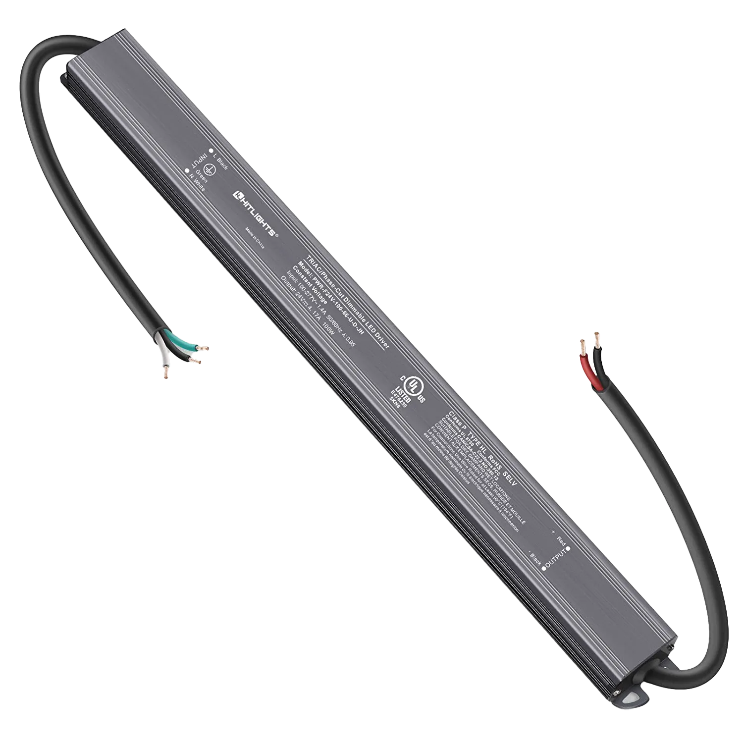

Have you considered line voltage tape? LEDI LINE VOLTAGE TAPE
I was looking for something 120v with end feed connector.
I think one issue in this scenario is that he doesn't just have a triagle truss. I think he said it has at least one vertical member right in the middle, and he has NM stubbed out only on one end. So he'd have to go around that center piece with some kind of cable to feed the other side
Then it sounds like the horizontal piece is a 2x4 sandwiched between two 2x6, which has created a 1-1/2" wide recess where he's hoping to have the light strips or something (he though tracks lights)

This driver could fit in the 1.5" gap and be hidden
Wow, that 120volt stuff looks cool. Not a lot of info on their site.
I was looking for that HitLights driver but couldn't find it. I've used it before in various wattages. It's good.

Here is this one ready to order. You can also get a hardwired adapter kit.
Begs the question......with both options viable and available, which one is better? Price doesn't look like it's going to be very different.

I've installed several brands of 120v strip, and every one has been a short cord that connects in your j-box.
Awesome if you have room for a shallow handy box.

I had one for the track at each truss. I can exit the back of it to get to the top of the truss. Could work to either power a transformer or just the direct 120v strip
James L
Kansas Cty, Mo, USA
direct 120v strip
That's the part I'm talking about. The "direct wire" option for the 120v strip is a cord.
Where and how will you junction the NM to with the strip cord? If you're ok with a shallow handy box (smallest j-box I know of) that would be the way to go, for sure.
