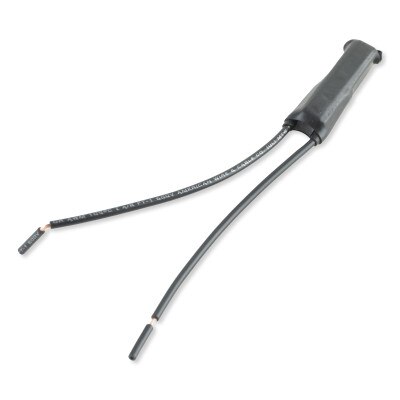

According to the spec sheet, it is necessary to have a minimum of .5 Amps of current @ 120vac for a TORK ss20 auto off in wall timer to control lighting load correctly. The ss20 timer switch is terminated to the coil of a lighting contractor, drawing .01 amp. is it possible to install a resistor parallel at the lighting coil in order to achieve the minimum .05 amp? With out burning up the coil on the lighting contractor.
thanks in advance for the support
