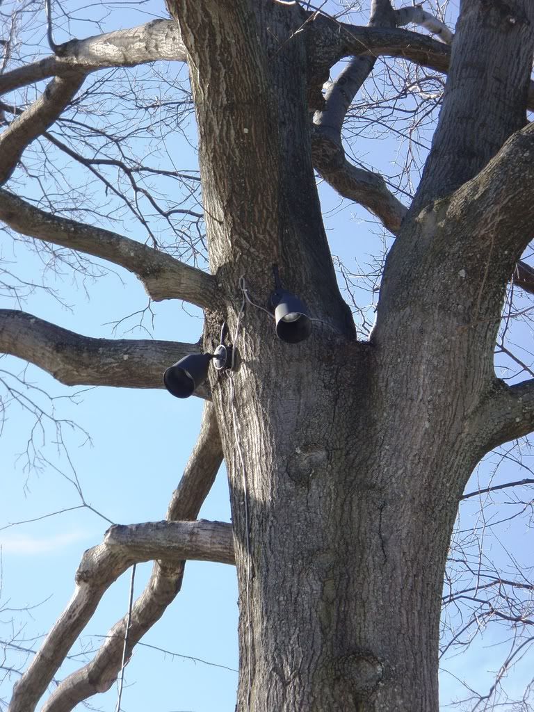

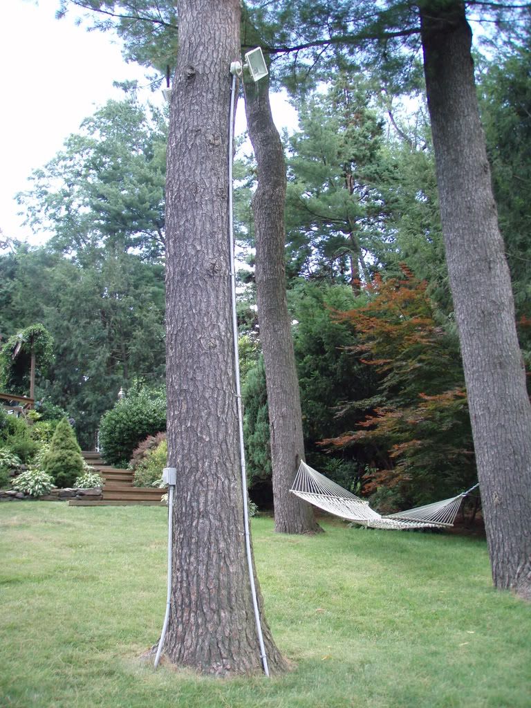

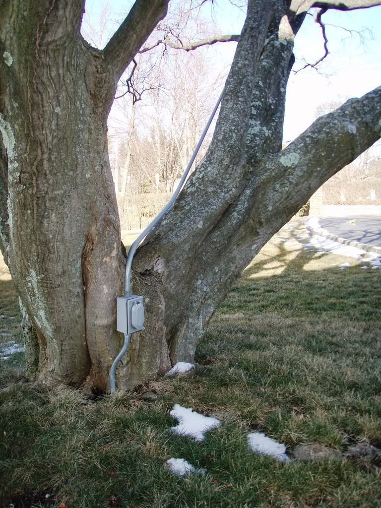

In your photo's is the UF cable acceptable to be attached as shown ? Is that a screw connector on the EMT ? Nice bend BTW. Did the installer ever work in a muffler factory ?:roll:
I didn't post these to show great work, just to show the different methods of installation I have taken pictures of.
