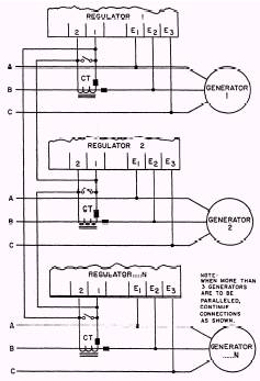

IMO, the old way of maintaining a proportionate sharing of load between paralleled generators was thru cross-current compensation! Each generator CT are connected in series and the generators behave according to their share of the load. Here's a web picture I grabbed (CTTO)
