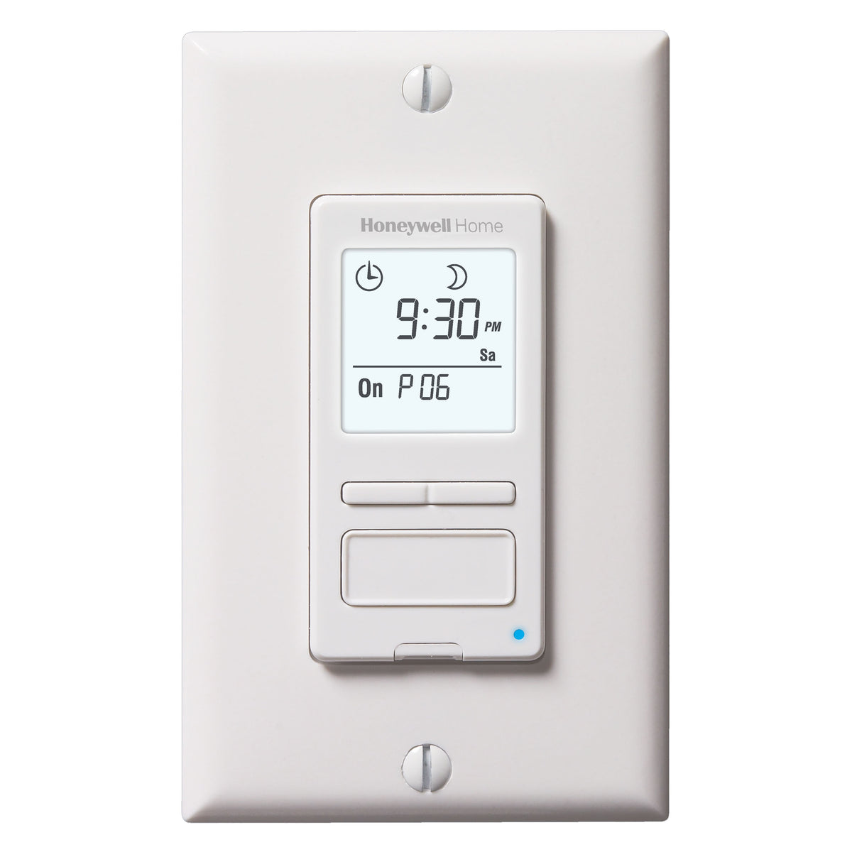

I am installing two lights on the outside of a residential garage, the owner wants them on a timer. He has a small digital timer that plugs into a receptacle and what ever you want to control plugs into the timer. I don't think that will work in this application as I'm using EMT and that would mean I would need to run a cord and plug out of a junction box and plug into the timer which would be plugged into a nearby receptacle on the same circuit, doesn't sound right? He also does not like the old style timers with the wheel and stops. Any ideas would be greatly appreciated.

Since you're using EMT, you put a box with a raised cover that fits the timer either:
Where you either already have or will need a junction box to connect new to existing EMT, or
Where you would otherwise need an LB or other fitting where you come through the wall, etc.
The orange and blue stores stock automatically-adjusting, programmable, astronomical timers.
And no, don't even think about stuff like plug-in timers, or rotary knobs, or sliding tabs.

I have used these with no problems. They do require a neutral at the timer.

Neutral should be no problem, this timer looks great, thank you for your help, very much appreciated.
