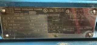

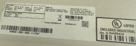

I have a situation where contractor run 200 amp wire and breaker to a starter of 30 hp motor.
I am swapping the starter for abb vfd.
Can I keep the 200 amp breaker or should I replace it with smaller?
Read the fine manual.
Eta: You may need to be using fuses. The breaker could stay but fusing or other protective device will need to be installed. RTFM
