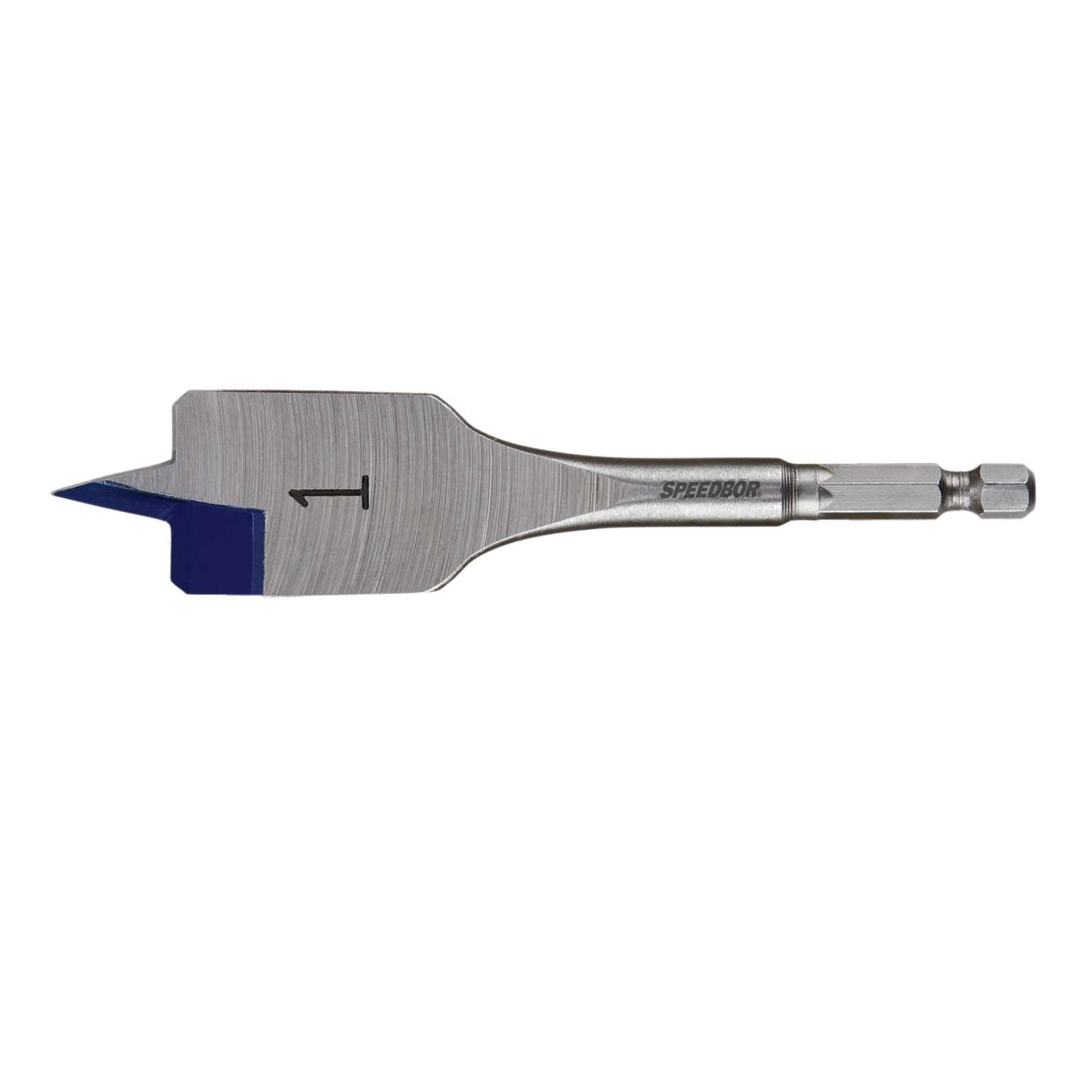

If you have trouble picking up the speed of the cordless drill, you could chuck a flat spade bit in it so that the sensor would detect the changing proximity of the metal from the side of the bit.

Perfect! That's exactly what I was thinking of using!
